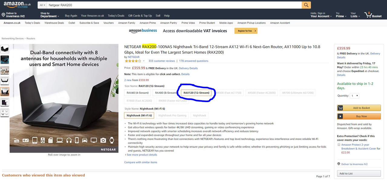

I went to go check my pre order on the RAX200 just now, and noticed it didnt have the 5 Gbps port, which was one of the main reasons I was looking at the AX line.
Ended up canceling my RAx200 and ordered the RAX120 for that port, and faster CPU.
