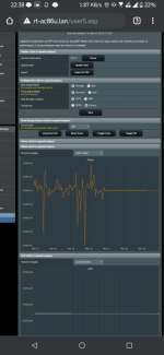

I think latest merlin beta2 broke ntpmerlin (at least chrony).
Since I've installed it, chrony doesn't work. It has nothing on "sources".
Reinstalled and nothing
