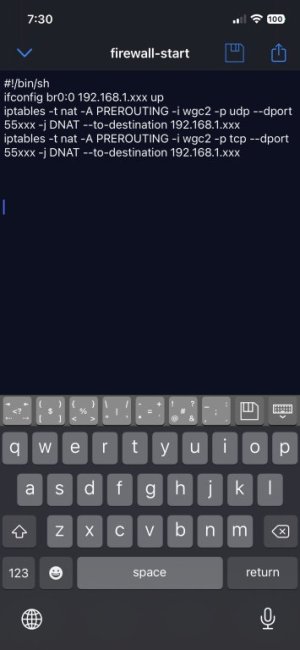

I was able to open the port on the fireguard vpn using the following lines only in firewall-start
ifconfig br0:0 192.168.1.xxx up
iptables -t nat -A PREROUTING -i wgc2 -p udp --dport 55xxx -j DNAT --to-destination 192.168.1.xxx
iptables -t nat -A PREROUTING -i wgc2 -p tcp --dport 55xxx -j DNAT --to-destination 192.168.1.xxx

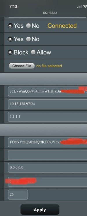

I am running transmission on the router. in transmission settings.json I setup a bind ip for transmission "bind-address-ipv4": "192.168.1.xxx" that way I can have that specific ip go through the vpn. In order for this ip to get internet I had to add the br0 bridge command to firewall-start.
@ZebMcKayhan I didn’t open the inbound firewall as you can see. However, I have no knowledge of how to do this things, I am piecing up different information from the forum and running tests. If there is better way to achieve it I would love to know. Thx
(see attached settings)
Thanks. That adds context. Also explains why you did not need the forward rules. You were talking to the router itself. No need to forward.

thanks Jeffrey, i made the changes and seems to work just fine. port is open on the wireguard vpn. will report if any issues.
