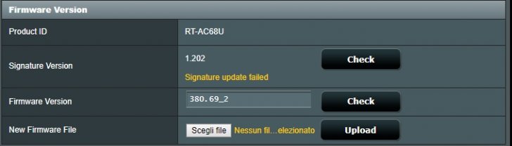

RT-AC68U Firmware 380.69_2:
AiProtection -> Signature checking ... Signature update failled (!?)
Question: Does AiProtection still work on this firmware?
Same issue here:
AI Protection works, even though I'm on a lower signature version, as I just got an alert e-mail this morning regarding a blocked site. @RMerlin, could this just be an Asus server not responding? If so, do you know which?
Thanks Jack, that whas quick. Will give it another try tomorrow. Is the signature not automatically updated normally? I just reverted to 380.69_2 yesterday, did a clean install. Normally I don't even pay attention to the signature versions, to be honest...
I noticed the error on my router, so went to github to track down the signature updating script to see what goes on! Assuming I found the right script/download path, seems a bodge job from Asus.
I have described the same issue in the previous page on my AC87U...
@RMerlin, hey there chief :)
First and foremost thank you once again for all you efforts! Switching however into pester mode: I've gone through the 382.1 thread and saw AiProt signature were already brought up broken and fix.... however this is how it looks for me in the 380.69_2:
Product ID RT-AC87U
Signature Version 1.202 Updated : 2018/01/21 02:00 Signature update failed
Firmware Version 380.69_2
as for JFFS
###@router:/jffs/signature# ll
-rw-rw-rw- 1 ### root 351438 Jan 19 06:12 rule.trf
renaming the file for a forced update didn't help :(
And the funniest:
###@router:/tmp/home/root# ll /tmp/sig*
-rw-rw-rw- 1 ###root 70 Feb 4 10:34 /tmp/sig_upgrade.log
###@router:/tmp/home/root# cat /tmp/sig_upgrade.log
---- sig update real normal----
---- 1205 ---
---- sig_ver: 1205 ----
UI still shows fail and stuck at 1.202
When checking again, it apparently is able to retrieve it again. However, it stays at 1.110 and says it's up to date?
Asus says it can take up to a day before the correction on their side gets fully propagated.
