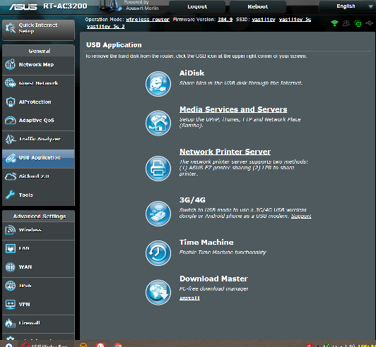

the download Master is not there anymore...
how did you have acces to your already installed Download Master?
thanks for answering.
rgds
If images or the GUI are flaky try power cycling the router , if that fails you'll need to reset.
