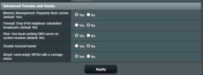

What/where is option one. In ipconfig /all it does show a default gateway and DNS server at 192.168.1.1
I appreciate everyone's time helping me. It is so close now....
