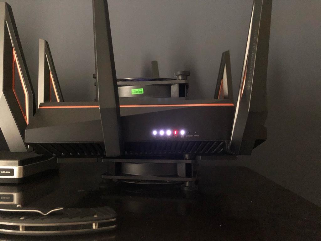

Also why is 5ghz band 2 occupied in AI mesh when I have it hardwired??? Makes no sense
It self corrected after I rebooted modem and routers
But not sure what happened

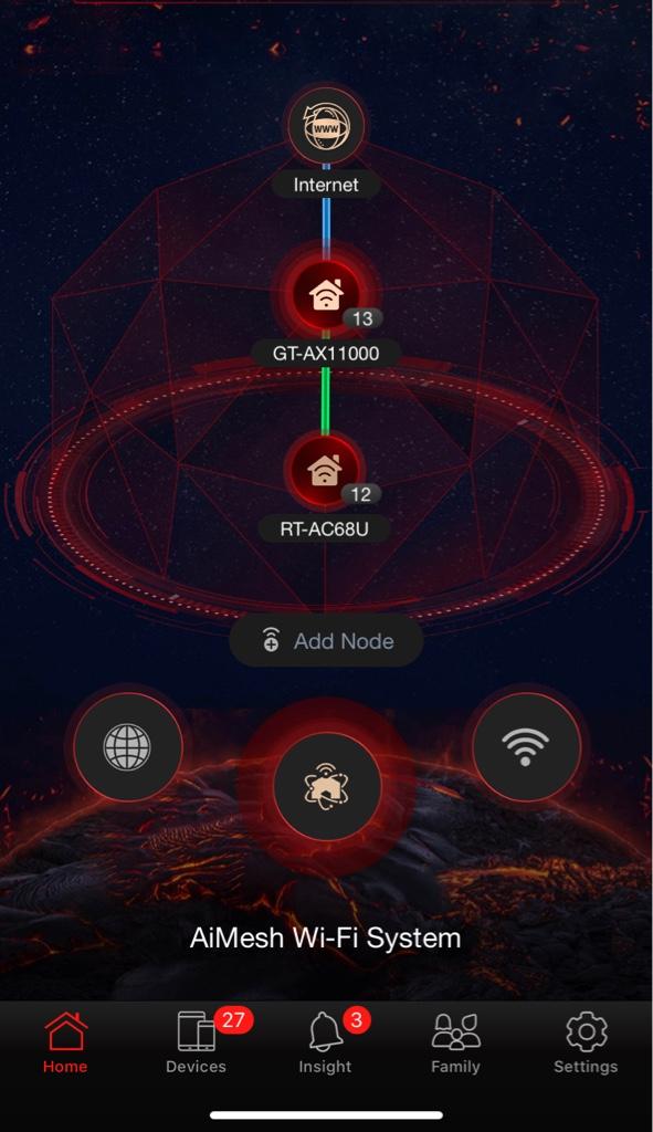

I got an ax11000 and the ac68u. I have them set up via aimesh. My ? Is I currently have it set up with a wired backhaul . When I speed test connected to on both nodes I’m pulled 200 Mbps which is my internet speed. If I disconnect the Ethernet and use aimesh wirelessly. On the AX11000 I get 200mbps . Then in the 68u I legit go from 200 Mbps to 60 Mbps. ? I have tried to moved the 68u close even right next to it and still the speed wireless is at 60 once I connect the Ethernet it’s fine
That is same as ax88u. That is one reason I return ax88u and get gt 5300
