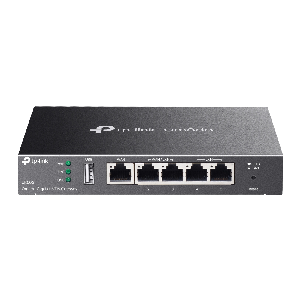

TP-Link ER605 can do that and it's only $60. Some of the features though require Omada controller. The hardware is tiny, don't expect great VPN speeds. It's a low cost solution. Omada controller can run on a PC, no need to buy the hardware controller. Don't count on Dual WAN feature in Asuswrt. It's not working reliably, may not work at all for what you need.
