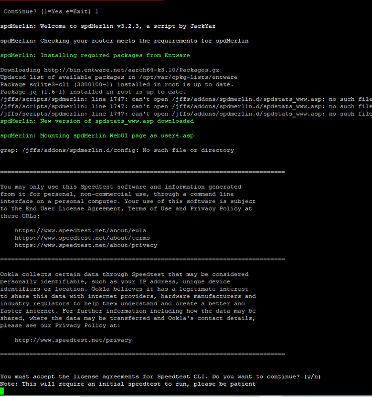

When installing I get the errors I posted in my post #563 above, namely:
/jffs/scripts/spdmerlin: line 1747: can't open /jffs/addons/spdmerlin.d/spdstats_www.asp: no such file
I'm using cloudflare DOT resolvers 1.1.1.1 & 1.0.0.1 on the latest Merlin firmware with no other dns related scripts, everything is "as standard". I've tried updating after installing, force updating, clean installing with no other addons (I use skynet, diversion, udivstats & conmon usually), re-formatted the USB & jffs partition but still get the above errors when installing. It ran fine on my old RT86U.
Let me know if you need any more info.

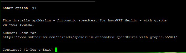

Edit: Here you go. The first screenshot when installing:
The second screenshot showing the failure:

FWIW the errors you are seeing in the installation, while undesired, do not impact script functionality. I have just pushed a fix to eliminate the install errors. I'll be surprised if they impact the script running!

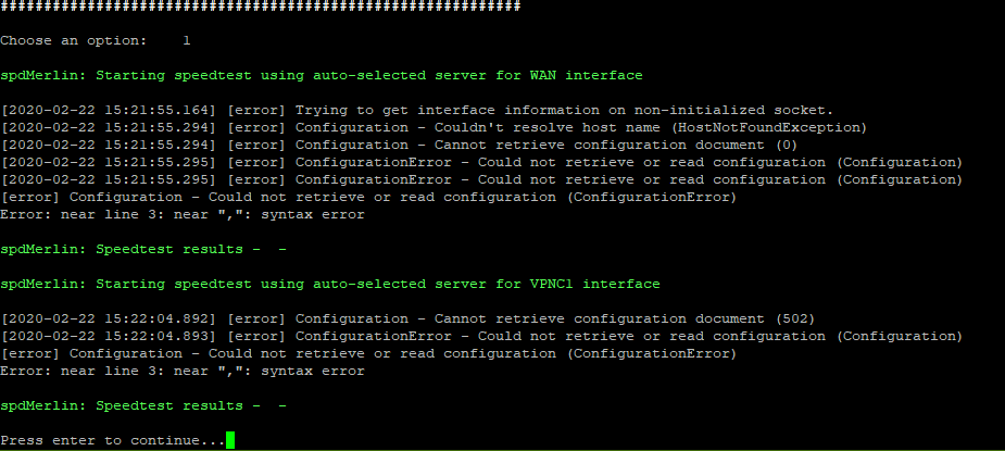

Yes. I've also done a few "from scratch" installs too - format the USB & jffs partition - same result. If it helps, here's what I get if I try running a speed test:
[2020-02-20 19:45:39.810] [error] Trying to get interface information on non-initialized socket.
[2020-02-20 19:45:39.941] [error] Configuration - Couldn't resolve host name (HostNotFoundException)
[2020-02-20 19:45:39.942] [error] Configuration - Cannot retrieve configuration document (0)
[2020-02-20 19:45:39.942] [error] ConfigurationError - Could not retrieve or read configuration (Configuration)
[2020-02-20 19:45:39.943] [error] ConfigurationError - Could not retrieve or read configuration (Configuration)
[error] Configuration - Could not retrieve or read configuration (ConfigurationError)
Error: near line 3: near ",": syntax error
spdMerlin: Speedtest results - -
spdMerlin: Starting speedtest using auto-selected server for VPNC1 interface
[2020-02-20 19:45:43.428] [error] Trying to get interface information on non-initialized socket.
[2020-02-20 19:45:43.559] [error] Configuration - Couldn't resolve host name (HostNotFoundException)
[2020-02-20 19:45:43.560] [error] Configuration - Cannot retrieve configuration document (0)
[2020-02-20 19:45:43.560] [error] ConfigurationError - Could not retrieve or read configuration (Configuration)
[2020-02-20 19:45:43.561] [error] ConfigurationError - Could not retrieve or read configuration (Configuration)
Hope it helps someone.

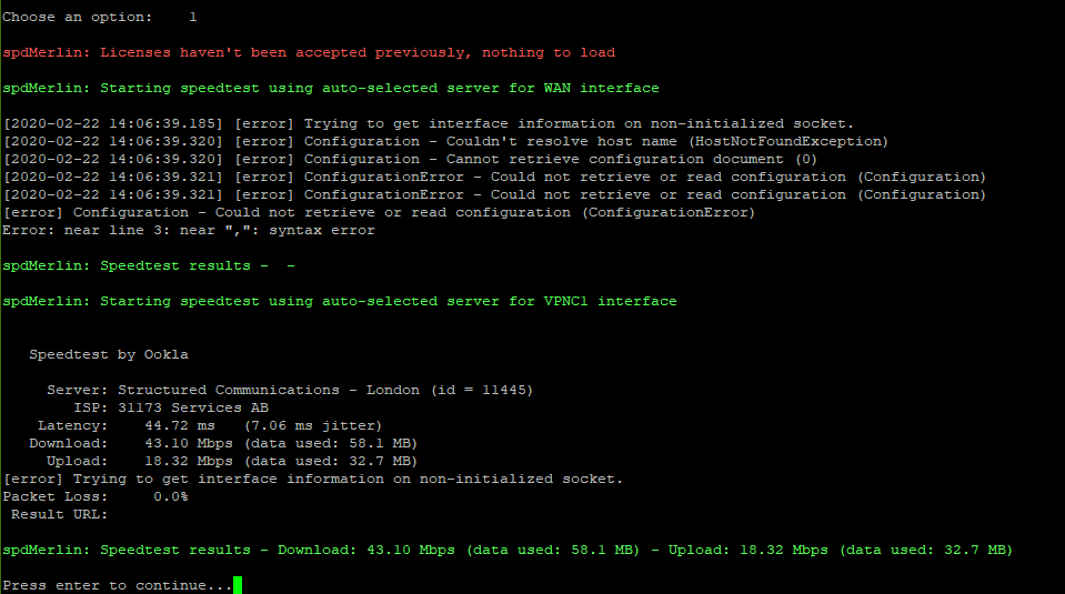

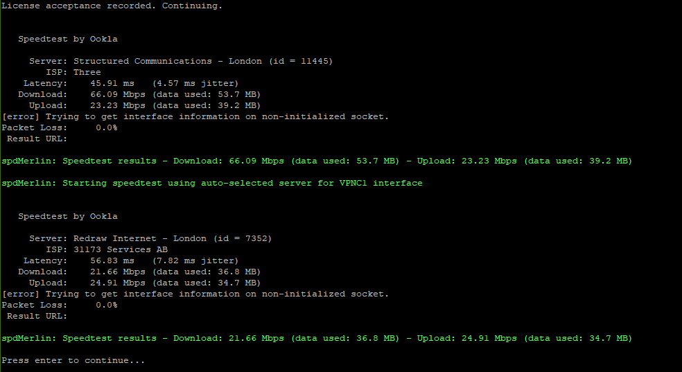

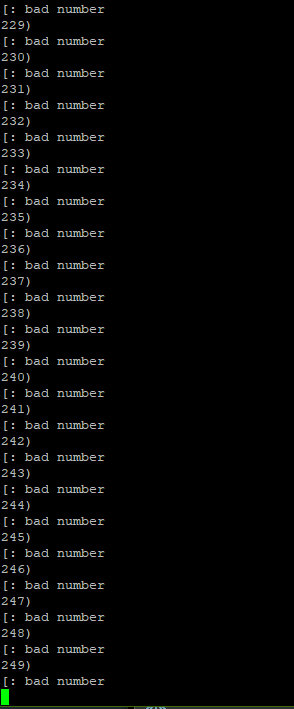

Hi Jack, thanks for bearing with me on this. OK, we're almost there - the usual errors I reported earlier regarding installation have now gone, but there was one error that flashed up before the screen switched back to the menu after installation, so I was unable to capture it I'm afraid. After installing I rebooted, updated & force updated just to be sure everything was right. I did however notice that an initial speed test didn't run after accepting (y) the Ookla terms.
I could see the UI on the router interface which confirmed that no speed test had occured, so I SSH'd into the amtm terminal & tried a speed test which worked, even though the results were approx half the speeds I get:

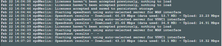

I then tried another, which failed, apparently it had "forgotten" that I had previously agreed to the Ookla terms:
A look at the router logs confirmed this:
Speed test on my ovpn connection works OK, but not the WAN, so it's half working. I then went back into the amtm terminal & tried to choose a preferred server for WAN (option 4) which didn't go down too well:

This was recurring & the only way to stop it was to close the session & reboot the router.
It seems to me, with my (very) limited knowledge, that the persistent storage is not very persistent & is forgetting the installation settings? Just a guess, from what I can make out of the logs....what do you think?

I'm unable to scroll back to see the error because the screen changes immediately back to the amtm menu after installation has finished - are there any installation logs kept anywhere that I can access?
I noticed also that when uninstalling there are errors which look similar to the errors when installing, but again - they disappear too quickly to capture. It would be ideal if the user had to press [enter] after installing/uninstalling before going back to the amtm menu - this would then enable log checking by the user & make trouble shooting by yourself easier?
I will try again now & see if I can capture it......
You should be able to scroll back up past the amtm menu. Otherwise try manually installing via the command in post #1
OK, reinstalled & updated but couldn't capture the error I'm afraid. Speed test now fails completely again:
....sigh.
Yes, I can scroll up - but there are no installation logs/reports, they disappear - only the chosen options by the user remain.
