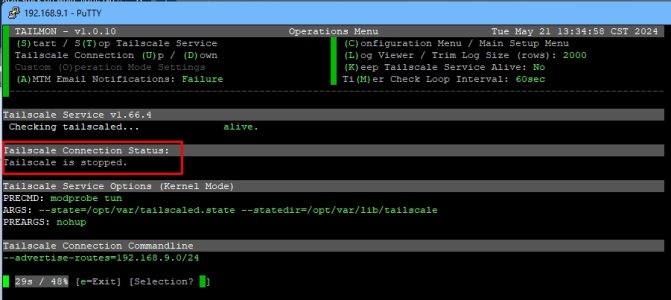

Dang, you're absolutely right. Didn't see that when I updated.
Couldn't screen-capture the message (too fast) but I went out of Tailmon to the CLI and just typed tailscale up, went back into Tailmon and it seems it connected OK. No other changes, I was and remain in Kernel mode.

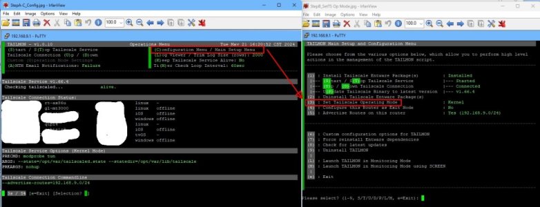

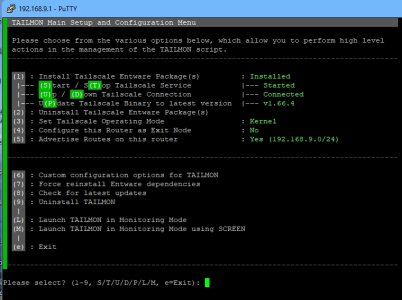

Mine's a very simple setup. Kernel mode, subnet, no exit node, no special options but see attached.

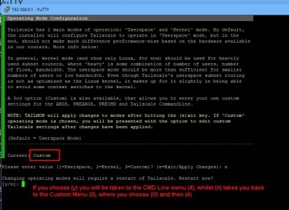

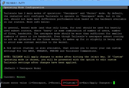

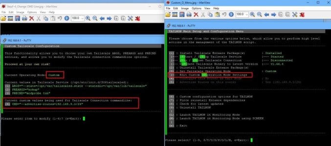

To get into Custom mode either:
For Custom Commandline Options, go to (C), 3, 3 for Custom (of Userspace, Kernel, Custom), exit (e), y to restart the services then you should get a prompt to customize the Tailscale settings, choose y, then select (4) and amend the above line.
OR
For Custom Commandline Options, go to (C), 3, 3 for Custom (of Userspace, Kernel, Custom), exit (e), n, then you should see the extra menu under the Custom Menu, (O), where you can amend the Custom Tailscale settings, you then select (4) and amend the above line. If you say (n) to a restart, you will need to restart it manually from the main menu after you make the changes.
With Custom Mode enabled, you will (from this point on) see the extra menu under the Custom Menu, (O), where you can amend the settings again if needed.
Let us know how you get on :)

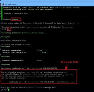

@Viktor Jaep see the StepE attachment; some weird double (y) questions and an error (from 1.66.4 maybe?) plus as above, tailscale went down OK, but did not come up again, until I did a CLI tailscale up?

Not 100% sure but I think what you are after is site to site, if so, see the post in that link and also Colin's post which refers to Tailscale's site to site instructions.
Essentially what Viktor said:
i.e. append “--accept-routes” after “--advertise-routes” on the command line.
Note with the latest 1.66.4 I believe you no longer need to actively disable stateful filtering per Colin's post; it is now disabled by default.
To get into the Custom Commandline Options, go to (C), 3, 3 for Custom (of Userspace, Kernel, Custom), exit (e), y, then you should get a prompt to customize the Tailscale settings, you then select (4) and amend teh abovce lines.
You wil also see an extra menu under the Custom Menu, (O), where you can amend to again if needed.

I have looked to the sie-to-site, but there's something missing and I do not know how to correctly configure it.
My ip route show does not show a route to route B.B.B.B/24 via de tailscale0 interface.
Great... gotta love how rapid development on their end is breaking the functionality of their client due to added or deprecated features. I'll start reading up on the .4 changelogs and start playing with it on my test router. Ugh. Thanks for the heads-up!
Hello, I first wanted to say that this is awesome!! Thank you so much for this, I have been hoping for a long while something like this would be created.
I also wanted to post that the solutions mentioned earlier also worked for me. I have 2 ax86u routers one at home and one remote, I was not able to access or ping my devices on the remote network and adding --accept routes to the custom values for command line fixed it
--advertise-routes=x.x.x.0/24 --accept-routes
Thank you everyone!!
