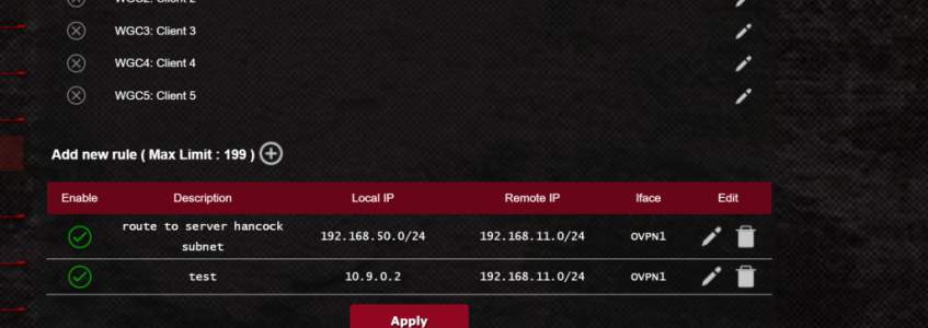

so is this why when i posted back when beta 1 first came out that my vpn was not working.. i could only ping 1 direction with redirect none that i had to add the follwing director rule to get it working again and change not to use the direcor?
