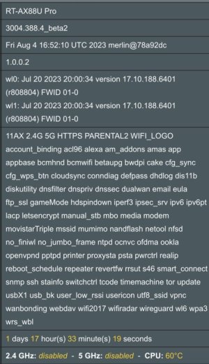

On at rt-ac88u pro
So 17 hours now in, and so far everything’s pretty stable.

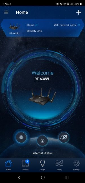

Currently, I guess it is known thing- ASUS app cannot connect remotely, unless VPN is connected.
Shows Security Link status.
Not sure why is it.
Under VPN it works like a charm
