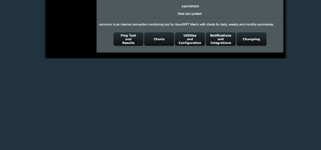

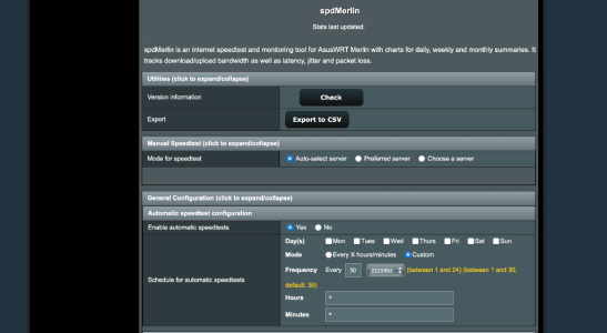

Hello,
i have some issues in add-on module like conmon or speedmerlin don't work properly.
There are some part missing or don't work when click on.
Try in 3 internet clients (firefox, chrome, safari...)
thanks for help
