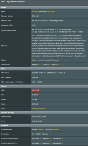

How much memory should there be in RT-AX86S? 512 MB or 400,97 MB?
For your install/configuration, exactly as shown.
Total: 512 MB in Network Map or 400,97 MB in Merlin Tools?
Network map rounds up to the next amount (4, 8, 16, 32, 64, 128, 256, 512, 1024, 2048). Tools page pulls numbers from /proc/meminfo and divides by 1024. Could be that what Linux sees isn't all that's installed. Memory is an art in Linux, it seems.
Understood. I thought that maybe there was a change in the compilation options for the server part in the latest version.
Thank you for the information.
It looks like Asus has installed 100MB less RAM in RT-AX86S than the specs say (512MB)...
No they didn't. Some of the memory map is reserved for other purposes. The same discrepancy can be seen on my router which has 1024MB:
# free
             total       used       free     shared    buffers     cached
Mem:        933964     877492      56472       4144       3092     520540
I'm not sure. Only with RT-AX86S do I have such a big difference.
RT-AX56U - ~498 MB from 512MB
GT-AX6000 - ~995 MB from 1024MB
RT-AX86S - ~401 MB from 512MB
