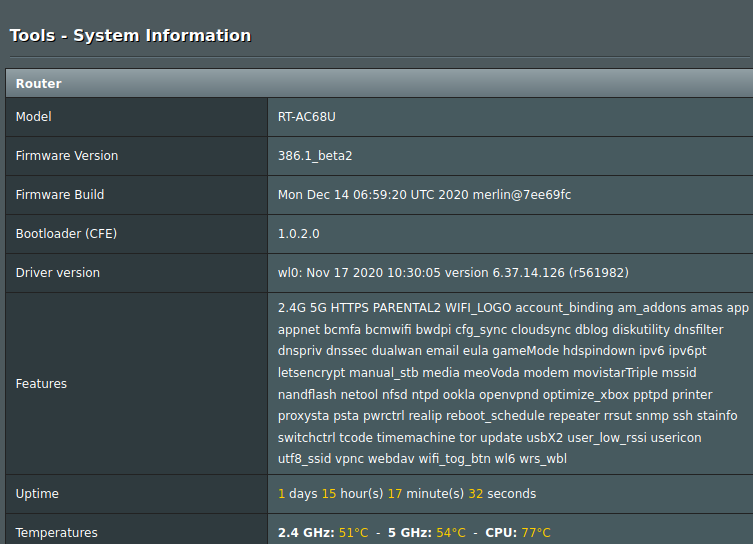

Configuration:
RT-AC68U, 386.1beta2, FlexQos, VPN Client with Policy Routing.
54% memory usage, 26+ clients.
I feel in the 386 version, the memory usage is a lot better. I am running and have over 50 devices connected and it's running smooth. Right around 68% memory.
