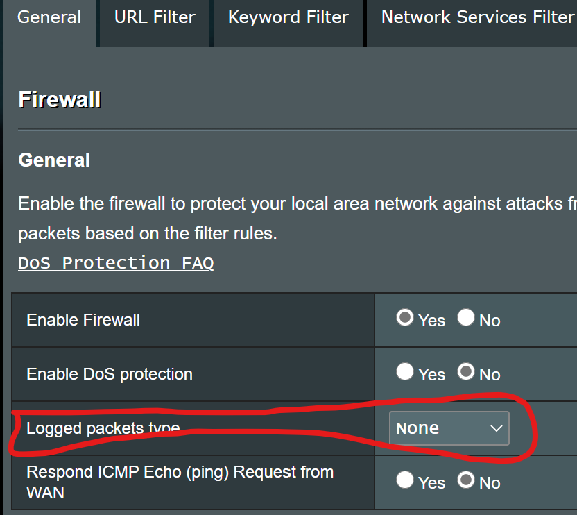

Unrelated to Beta5... However,
Turn off logging in the firewall section.
Did that, still getting the errors. Why are so many ip's blocked? How can I get more info on this?

Do you have Skynet installed? If so, those are log entries that show up from Skynet logging banned IPs. I used to get them all the time before I removed Skynet.
