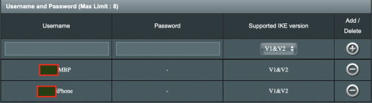

A question on VPN server:
- Are you running IKEv1 or IKEv2? Are both supported in beta5?
Oops ... I don't really know the answer. However if you see my configuration I selected both V1 + V2 for supported IKE version.
