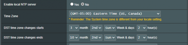

I remember a while ago having issues with time scheduling and I remember going into Administration/System and changing the DST time to something, but I can't remember which one to change.
I believe is based on your Time Zone. Once I changed it, scheduling started working again.
Maybe someone here can tell you which one to change and to what.
