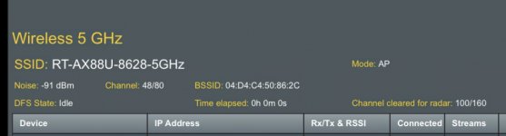

hello, I switched to version 386.1 without problem. however, I have the channel for 5ghz which changes even though I have set it to manual. I set it to 100, and after 2 days it changes to 48. On the previous version (384.19) I stayed 120 days without changing the channel. which channels support 160mhz?
I experience the same on my RT-AX56Us running stock or Merlin firmware using 80Mhz. Please report it to Asus as I'm trying t get them to take it seriously.
May not be a bug when you use DFS channels. Much better to not use those channels that can be used by RADAR.
