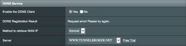

having DDNS update issue with tunnelbroker.net - Request error! Please try again.
log showing 500 internal server error.
start_ddns: update WWW.TUNNELBROKER.NET default@tunnelbroker.net, wan_unit 0
inadyn[1630]: In-a-dyn version 2.8.1 -- Dynamic DNS update client.
inadyn[1630]: Update forced for alias xxxxxx, new IP# xxx.xxx.xxx.xxx
inadyn[1630]: Temporary error in DDNS server response:
inadyn[1630]: [500 Internal Server Error]
inadyn[1630]: Will retry again in 600 sec ...

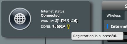

tried to manual update the endpoint ip in tunnelbroker.net website, successful updated and ipv6 is working.
but under router DDNS tab still showing "Request error! Please try again.",
internet status also showing exclamation mark with "registration is successful" message.

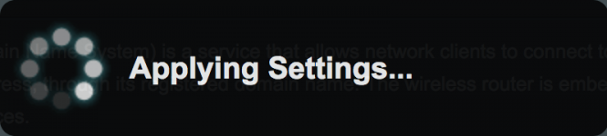

another issue, always stuck at "Applying Settings..." in DDNS tab
(after insert info and click on apply button, no problem.
click apply button again, got stuck).
