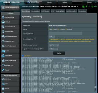

I need help. After installing the new Firmware version:386.12, a lot of errors began to pour into the System Log - General Log. What to do????
Oct 25 21:47:20 kernel: CPU: 1 Tainted: P (2.6.36.4brcmarm #1)
Oct 25 21:47:20 kernel: PC is at 0x40358890
Oct 25 21:47:20 kernel: LR is at 0x40182ee4
Oct 25 21:47:20 kernel: pc : [<40358890>] lr : [<40182ee4>] psr: 60000010
Oct 25 21:47:20 kernel: sp : beea0c20 ip : 4018cde8 fp : beea0cc4
Oct 25 21:47:20 kernel: r10: beea0cc8 r9 : 0000dafc r8 : 0000a620
Oct 25 21:47:20 kernel: r7 : 000000a2 r6 : 00000008 r5 : beea0c68 r4 : beea0c68
Oct 25 21:47:20 kernel: r3 : 00000000 r2 : 00000258 r1 : beea0c68 r0 : fffffdfc
Oct 25 21:47:20 kernel: Flags: nZCv IRQs on FIQs on Mode USER_32 ISA ARM Segment user
Oct 25 21:47:20 kernel: Control: 10c53c7d Table: 9913804a DAC: 00000015
Oct 25 21:47:20 kernel: dcd/9970: potentially unexpected fatal signal 6.
Oct 25 21:47:20 kernel: Pid: 9970, comm: dcd
Oct 25 21:47:20 kernel: CPU: 0 Tainted: P (2.6.36.4brcmarm #1)
Oct 25 21:47:20 kernel: sp : be3ffdf8 ip : 4018cde8 fp : be3ffe6c
Oct 25 21:47:20 kernel: r10: 40191020 r9 : 401913dc r8 : 00000000
Oct 25 21:47:20 kernel: r7 : 000000a2 r6 : beea0c44 r5 : be3ffe40 r4 : be3ffe40
Oct 25 21:47:20 kernel: r3 : 00000000 r2 : 00000230 r1 : be3ffe40 r0 : fffffdfc
Oct 25 21:47:20 kernel: dcd/9968: potentially unexpected fatal signal 6.
Oct 25 21:47:20 kernel: Pid: 9968, comm: dcd
Oct 25 21:47:20 kernel: PC is at 0x403590dc
Oct 25 21:47:20 kernel: LR is at 0xcc9c
Oct 25 21:47:20 kernel: pc : [<403590dc>] lr : [<0000cc9c>] psr: 20000010
Oct 25 21:47:20 kernel: sp : be7ffda0 ip : 403590cc fp : be7ffe6c
Oct 25 21:47:20 kernel: r7 : 000000b1 r6 : beea0c40 r5 : 4018cd74 r4 : be7ffea0
Oct 25 21:47:20 kernel: r3 : 00000008 r2 : be7ffdc4 r1 : be7ffdcc r0 : fffffffc
Oct 25 21:47:20 kernel: Flags: nzCv IRQs on FIQs on Mode USER_32 ISA ARM Segment user
Oct 25 21:47:20 kernel: Pid: 9971, comm: dcd
Oct 25 21:47:20 kernel: sp : be1ffdf8 ip : 4018cde8 fp : be1ffe6c
Oct 25 21:47:20 kernel: r7 : 000000a2 r6 : beea0c44 r5 : be1ffe40 r4 : be1ffe40
Oct 25 21:47:20 kernel: r3 : 00000000 r2 : 00000230 r1 : be1ffe40 r0 : fffffdfc
This is the dcd crash that has been discussed at length in this thread.
Either withdraw from the TrendMicro licence agreement or revert to the previous firmware until it's fixed.
EDIT: See post #241.
Reverting to previous firmware 386.11 doesn't solve the issue, as @RMerlin said: https://www.snbforums.com/threads/a...lable-for-ac-models.86647/page-11#post-870905
"Asus confirmed that the issue also occurs even with older firmware versions."
I'm not sure I'm following you guys...
But RMerlin then said "The issue is unrelated to the signature update". So while it may effect previous versions of stock firmware it may not effect the previous version of Merlin's firmware. I don't see any reports of this problem for 386.11 (but maybe I just missed them).
Yes that's what my original reply was referring to. It was unclear to me whether Asus saying "older firmware versions" meant only stock firmware or your previous firmware as well. Like I said, I don't see any reports of this problem with 386.11 (but maybe I just missed them).
@ColinTaylor With all due respect, please don't confuse people. I linked @RMerlin's response, then he himself did again, but you're still splitting hairs...
If I'm wrong, I'm listening - I'd like to understand what is really going on. Until the problem is solved, I just don't enable TrendMicro.
Probably because there`s no real reason for anyone to still be on 386.11, so probably a very small installed userbase.
The issue mostly manifest itself by filling up the system log, so most people aren`t even aware of the issue. Asus tested a specific older stock firmware which also had the issue, however neither of us started going further back in time, as we already knew enough - that the issue wasn`t from a regression, and was on Trend Micro`s side.
