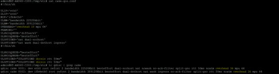

On 386.2 beta 3, ax86u. My connection felt like it was stuttering a bit while gaming, so essentially the connection felt worse right after I updated to latest beta release on time sensitive games.
I looked at cake settings and noticed my overhead values showed 36 instead of the expected 18. I was using "docsis" in the "cake-qos.conf.add" to have set as additional DLOPTIONS and ULOPTIONS.
It's worth noting that the overhead 18 and mpu 64 values were already defined in the GUI (so therefore reflected in the "cake-qos.conf"), the "docsis" value was added in "cake-qos.conf.add" as that's what I was used to doing when running earlier versions of cake installed from CLI.
At any rate, I thought the use of docsis would overwrite any overhead values already defined from the GUI but it doesn't seem like that's the case as can be seen from the screenshot. I removed docsis and now its back to overhead 18, so I'll leave it like that for the interim. Just noting my observations.
