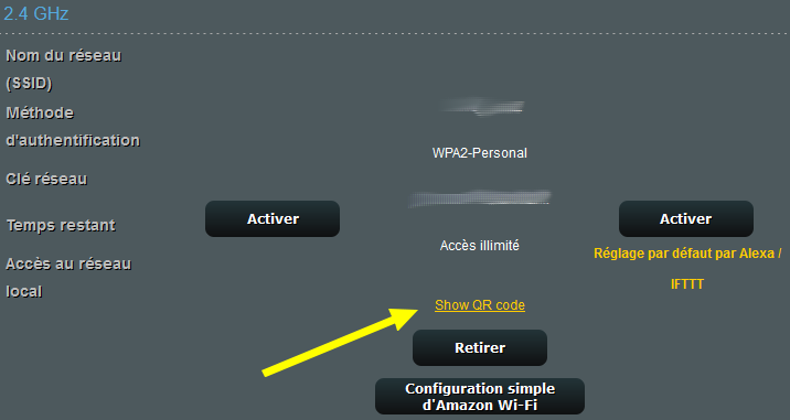

What authentication method are you using? There's no webui error, yet your webui isn't fully loading, with that field remaining empty.
Thank you for your answer.
I use the WPA2-Personal authentication method :

For your information, even with the previous Merlin firmware, the boxes were always empty. I don't even have a link for the QRCODE.

On the other hand, in the guest network tab the QRCODE link works well :
I would like to understand what is going on and find a solution.
This is the only problem I have. Otherwise everything else is very stable :
How long are your SSID and WPA Keys?
Both of my 2.4 and 5GHZ SSIDs are 13 characters long and WPA keys are 11 characters long.
I'm using WPA-2 Personal authentication method. I've the QR CODE link under 2.4GHZ but the link doesn't even show up under 5GHZ. No issue with QR CODE under Guest Network as it's working fine.
Hope this explanation helps you getting to the root cause of the issue.

Do you use anything that modifies your webui? It might be incompatible.

I don't use anything that modifies the Webui. I also do a hard reset (WPS reset) after every merlin firmware update to get the best performance and stability.
I don't have any extra plugins or other tweaks, just the merlin firmware.
For information I use the latest version of Firefox and the latest version of Edge.
I don't understand where this problem comes from and apparently other users have the same thing.

What browser extensions have you installed? If you do, start your browser without it.
Are these the only add-ons? Otherwise you could try to start Firefox in safe mode:

Thank you for the procedure. Here is the result with Firefox opened in safe mode :
The problem is the same. The problem is the same. Empty boxes and no QRCODE.

For test try to change SSID to some simple eg "test" if you have signs qr code not likes
