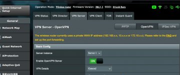

am trying to confirgure Openvpn, and having trouble looking for this option for my vpnserver: Redirect internet traffic

As the changelog says, this is an OpenVPN Client option, not an OpenVPN server option.

Sorry for being noobs
with the yellow highlights, does that means i needs to do changes ? Already done port forwarding and still not working ror my von server

Define "not working". What have you done and what errors are you getting?
Wouldn't a private WAN IP prevent port forwarding and thus even running a VPN Server? Warning message indicates a Private WAN IP is being handed out.
The port forwarding for the VPN server needs to be done on the upstream router not the Asus. The exported config then needs to contain the public IP or DDNS address. That's all.
K - was assuming the ISP was handing out a Private WAN as some are known to do. This is a Double-NAT situation then. Carry on... ;)
