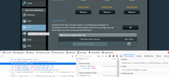

I’ve just dirty upgrade my RT-AX58U from 386.1_? to 386.3_2, and the 5GHz part of the Guest Network has been missing, but these networks are still existing and usable.

The qr codes are displayed. I shift-refresh, then deleted the site data, then tried in chrome, then edge (where I’m sure I never log to my router admin panel) and I have the same problem. The 5GHz guest networks are missing.
The div is here, but it’s not populated as you can see on the screenshot.
