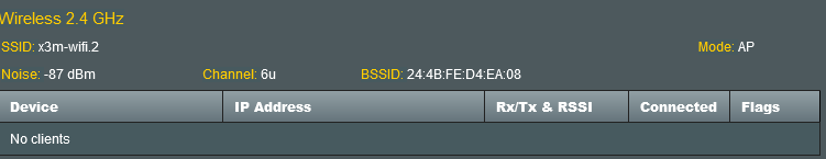

I have run beta3 for (2 days 13 hour(s) 29 minute(s) 22 seconds) and my wifi aimesh node on 2,4Ghz dissapered.
That happends with all latest alpha and beta firmware.
Seems disassociated and not connecting again, have to reboot aimesh node to get it back on 2,4 Ghz, it's after ~60 hour uptime.
Screenshot 2021-12-31 at 14-49-00 ASUS Wireless Router RT-AX86U - Wireless Log.png

I have also discovered some time 1 hour difference, see log: look at <<<=== TIME HERE in code tag
Same time my wifi 2,4Ghz dissapear
