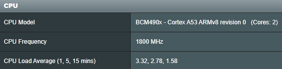

The load is relative to the number of CPU cores in the system (it should be divided by number of cores), CPU load is not the same thing as CPU usage .
So a load of 1.00 on a single core CPU (100% 1 core used) but in a quad core CPU the full load is 4.00.
Ok, so my average load is indeed very high? Why is that?

I don’t know all processes, services, I/O running in your system.
You have only 2 cores CPU so 1.58 (15 minutes) is not bad.
You can ssh into your router and run top command.
Maybe this release is more resource hungry… I read than also other users have noted that.

You may be on to something. From the changelog;
itterentropy-rngd was replaced by haveged. Haveged is more resource-intensive, but it works properly under older 2.6.x kernels.
