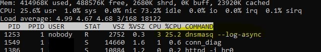

I'm experiencing a strange issue with an AX88U as every 2 days aprox, the core 4 reach 100% and get there. After some time few cameras cannot establish the wifi connection and the connection start being slower.
In the log there is just connect and disconnect STA records, but in top the process dnsmasq is getting so much cpu, so probably this is the reason of the continous 100% usage of core 4.
A reboot fix this, but I did it 2 days ago and today happened the same...
Any suggestion?
Do you have DNSSEC enabled? There is a nasty bug in dnsmasq 2.86.

I had this problem too, but my problem is probably caused by a third party plugin using dnsmasq. I originally thought it was caused by 386.4 using haveged instead of jitterentropy-rngd, but I'm not so sure now. It works perfectly on 386.3_2, 386.4 had this 100% CPU usage problem.
I couldn't figure out the cause so I switched back to 386.3_2.

Perhaps there should be a general recommendation to disable DNSSEC in 386.4,
Only if it helps. It’s a shot in the dark at this point. No one has confirmed yet that Simon’s latest commits fixed the issues.
I am kinda surprised that reverting to 2.85 is only coming in 386.5 and not a 386.4_2, at least as of today. :)

I think it even gets worse....on my OpenWRT build, getdns 1.7 (part of stubby DoT) isn't playing nice with dnsmasq 2.85. I had to roll that back as well. (@RMerlin....FYI)

Yea I haven't seen any actual issues with Haveged yet. I have however seen issues between Unbound and DNSmasq, and Stubby and DNSmasq.
I think we’re seeing more DNSSEC bugs from bad domains that expose these latent bugs, therefore they seem to impact many DNSSEC validators. Getdns pushed a fix just this week, as well.
