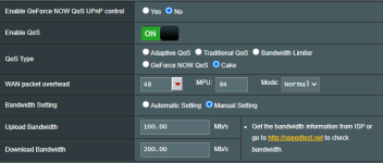

@kernol...do you use the default settings for cake and do you use the cake add on as well?
I did play with the Cake add-on some time back - but found I didn't need it.
I guess settings will vary a lot - but the below image is my current setup with PPPoE fibre connection at 100 up and 200 down.
I used to set speed at 5% discount to actual rated speed - but given the built in reduction that cake applies to whatever you specify - full speed setting works a treat for me :D ...
