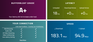

I stuffed the latest firmware onto my families RT-AX86U (& perhaps I'm not the best test environment being a busy family & all) but it seems my CAKE test results have suddenly worsened going from a typical A rating to C & D. Hmmmmmmm EDIT: actually gotten even better. We just registered A+ with Bufferbloat test by waveform ( I sometimes forget then when testing these things through a browser... You actually need a decently powered client or else you'll simply wind up with poor results... sorry my bad.

CakeQoS remains the champion for me and my setup as per pic below ...
Reverted to Cake and turned off TrendMacro ;).
MANY thanks for your perpetual quest to release AAA grade firmware.
@kernol...do you use the default settings for cake and do you use the cake add on as well?
