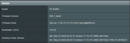

I was able to reproduce the RT-AX86U JFFS problem by reverting back to 386.5_2, then flashing 386.7 on top of it. It probably didn't happen before as I had the newer cferom already flashed, so it could be a problem when mixing the older cferom with the newer firmware content.
I'll remove the RT-AX86U firmware for now, I'll need to do more investigation tomorrow.
Didn't really pay attention earlier but noticed this below. Is 0.0.0.6 the newer CFE? If newer did it keep it when I downgraded?
