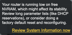

Is there some one happened like my AC66UB1 with issue of low NVRAM after dirty update?
Several of us (see my post here) have experienced that low NVRAM message after the 386.9 (Alpha, Beta, final) firmware update. The workaround is to perform a hard factory reset and reconfigure the router from scratch. Disconnect any attached USB drive before the hard reset, copy down all your settings (some will screen capture each GUI page) before the hard reset, don't import a saved configuration file post hard reset. RMerlin explained the reason/cause for low NVRAM issue post 386.9 update previously in the Beta thread:
Low nvram notification is nothing new, and is becoming increasingly common for that old model as it's running out of nvram space with every new firmware adding new nvram settings. It's part of why Asus is leaving it on the 386 branch most likely, as 388 probably adds even more nvram settings.
This 9 years old model is starting to show its age, with Asus having added lots of new features to it since its initial launch in 2013.
I might have to start considering removing some things from the RT-AC68U to save some nvram space. Reducing the number of OpenVPN clients would be such a thing, as each client consumes around 1 KB of nvram even while not in use.
Thanks very much for your help. I do have some DHCP reservation and OpenVPN configurations. Will do a hard factory reset and I believe it would work.

Dirty-ish update from 386.7_2 to 386.9 on RT-AC66U B1. Power switch restart before and after f/w upgrade, but no factory reset. I'm using router mode with 3 wireless guest networks and two non-guest wireless networks. There are around 20 DHCP address reservations. Not using any VPN or any customisations or external USB drives. After the update, RAM usage was about the same at 70MB with plenty of spare RAM. NVRAM I had not checked before the update, but after the update it climbed slowly from 65301MB to 65495MB (without me changing any settings), so it now has 41 bytes spare and is 99.9% full.
The new settings backup CFG file from 386.9 is 65,544 bytes in size, while from 386.7 it was 62,472 bytes. I'm worried that some settings may start dropping across reboots e.g. if I add any more DHCP reservations. Could that hapen? Will NVRAM gain more free space if I factory reset and manually re-make all settings (ugh.. please, no), or, noting earlier comments, have we 99.9% reached the end of the road with RT-AC66U B1 on Asuswrt-Merlin?
I just noticed that the low NVRAM warning is working. A flashing alarm bell icon in the webgui gives the following message:
Your router is running low on free NVRAM, which might affect its stability.
Review long parameter lists (like DHCP reservations), or consider doing a factory default reset and reconfiguring.
Review System Information now
The observations and questions in my prevous post remain valid. Is there a way to take the pain out of factory reset and reconfigure? Will it make any difference? @JackZhao did it make any difference for you?
See above, others have received the same warning. I commented in post #89 above that some of us have received that warning with the Alpha and Beta 386.9 firmware. My post #89 above has RMerlin's response why one receives that low NVRAM message on the older AC series units. One workaround to resolve that low NVRAM message is to do a hard factory reset and reconfigure the router manually from scratch.
