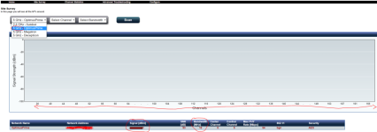

@RMerlin A completely unrelated question/issue that has been persistant for me through different firmware versions and clean flashes.
WifiRadar pages don't appear to be updated to handle displaying the 6ghz band correctly. Is this a known issue?
Attached is a screenshot showing the issue.
OptimusPrime is my 6ghz band.
