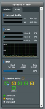

Dirty update from 386.7_2 to 388.1 on RT-AX3000 (aka RT-AX58U). Also updated mesh node RT-AX56U to 388.1. All went well until I noticed that on the web UI Network Status my CPU status was not showing any activity on the 3rd core. I checked the status from my cell phone app, and it displays intermittent 1% "Hits" on the third core, but no apparent "Load Balancing" between the cores. I have no way (or expertise) to confirm that the 3rd core is not being accessed. Some many, many moons ago, I saw this problem in stock Asus Firmware, and an update to Asuswrt-Merlin cured it.
This is likely an Asus problem and nothing @RMerlin can help with. I am just posting this to bring it to the attention of the community.
As this does not seem to hurt overall performance (but makes me nervous). I am going to wait for comments from the forum before I flash back to 386.7_2.

EDIT 5 Jan 22: Rolled back to Asuswrt-Merlin 386.7_2 this morning and all three CPU cores are now displaying in Web UI and Android Phone app.
