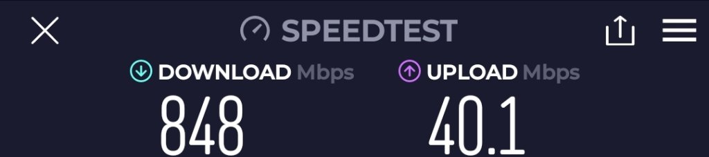

ETA: I just checked my 5Ghz band with Wifi Explorer on the Mac, and the router is performing great. It has me on DFS 100 channel and 160mhz rock solid! I’m averaging 730Mbps on my iPhone 14 Wi‑Fi 6 (802.11ax) with 2x2 MIMO. I’m on Comcast/Xfinity 1400 at the router. Just have to chalk up the site survey is broken for 5ghz. Or site survey doesn’t work for DFS channels?
I have the same package and I am getting about 850mbps on wireless.
