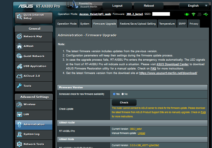

I just acquired a RT-AX88U Pro, has any one had experience so far with flashing the newly added merlin support for this model?
Just flashed the beta on the RT-AX88U Pro. Only issue I have noticed so far is,
I don't know if that is because it is on beta firmware, or if @RMerlin needs to take a look at the firmware update code for this particular model.

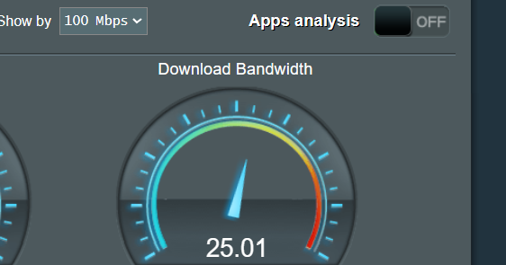

Fascinating. Never had to do that before from what I recall. Turning that on was only needed to see app-specific info but the overall bandwidth gauges would work...
Working on my AX86u without app analysis enabled; I understood this the same as you that it was only needed for per host or app specific measurement.
Checked on my GT-AX6000 and noticed this too. It's no longer reporting any throughput - both gauges stuck at zero.
Not able to confirm if it comes back after a reboot yet. Will try on the weekend.
Log out / log in makes no impact.
Honestly think its the bug i think it is, cos if you login and logout timer is 10 minutes and close tab and open it after lets say 24 hours a lot of stuff will report nothing even the internet speedtest will say n/a if so i believe, altho if already been told this is not the case for some reason i think it might be
I always logout and log back in and fix it that way, ofcourse im gonna keep eye out and report back if i see the bug, but i usually just logout before i close the router tab.
edit: better image
edit: before i forget i am on AX88U
