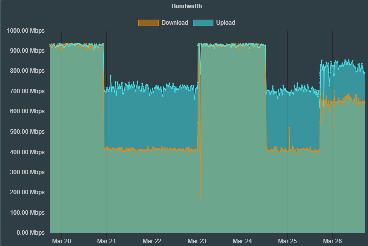

The only thing I can think of with skynet is that it relies on iptables, which can be pretty cpu intensive. Packet processing would experience extra slow downs.
CPU in the single digits except for peaks on occassion, but here are the averages
Doubt it's Skynet but after uninstalling it, and a reboot I did get some relief. Going to unplug the router from the modem for a minute or so, if no change then power off/on of the AX88 next.
Another factor to consider is , does the speedtest always use the same server? Does that server ever have issues? There are alot of factors to consider, and the only way for you to find resolution on this matter is to process eliminate. Other factors to consider, are there any other scripts performing cpu intensive task during the times these drops occur? You can determine this sometimes by indications made in the syslog that a certain script may be active or there may be indication that a script is performing some sort of maintenance task.
Been around here long enough to factor all that in. Random or the same Speedtest server the variation is minimal. Right after the router, I run from the PC I get my full speed, from the AT&T modem, full rated speed. CPU is running in the single digits on the router right when the sample is taken. I take 20-25 runs just to get to an average and weed out and high and low to minimize the variables. The log is clean, really noting running of significance. At this point it's process of elimination. Taking out Skynet got me closer to my normal, but can't fathom why as CPU has never been an issue and in the 386 family with the same scripts, never had a drop like this.
A reboot from the GUI, left me with the same results with Skynet removed. So it'll be a power off/on, let it settle down, then run the tests, PC, Modem, Router then average each out. One thing I did see but it's never been an issue is a setting from long ago, cloning the MAC of the PC when I had DSL in the early days. Will turn that off, and re do the passthrough setting at the AT&T device with the actual MAC addr of the Router if the on/off doesn't do it. Trying to be systematic about this since it's not impacting any of the wired clients (the important ones, like the TV's).
First goal is to fix it, second goal is to be able to reproduce on demand to report it if it's something related to 388 family. If it continues to be a mysttery, then it's a HW reset and start from scratch scenario if I can't replicate it. Then monitor for it happening again...
OK, power of/on, modem off/on, getting rid of the MAC Clone and redoing the passthrough, even built-in vs external libraries, in all cases no change. I'd say carrier but the their speedtest at the modem(resedential gateway) is fine;
Also good a the PC and what I would normally see at the router
Going to let it run overnite after all the individual reboots and run through all of the speedtests again. If nothing changes, then HW reset, start from scratch and setup all the scripts (incl Skynet) again, testing along each step of the way...
Yea the reason why I asked about this is because I wondered if you varied test servers to eliminate that as a possible variable. Also, are the speed test execution times coinciding with any of the speedtests conducted by the router. This could be another factor. Similar to trying to run two speedtest on two computers at the exact same time on the same network. This creates a variation in results during times of execution since both test runs may be competing to hold bandwidth.
Also, if possible investigate the logs in your modem specifically looking at lines that talk about the link connection between your modem and router to ensure at no point is your modem downgrading or adjusting the parameter. This could mean you are dealing with a bad connection from either one of the ethernet ports, possibly a bad ethernet cable, or bad modem firmware provisioning supplied to your modem from the ISP.

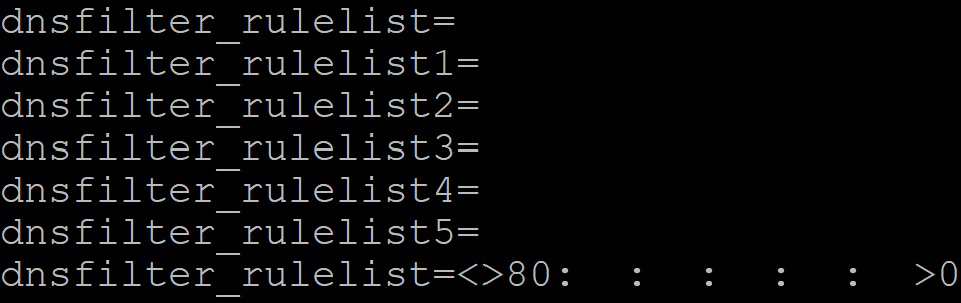

EDIT: I just noticed on the 388.2 routers, there is 2 NVRAM entries for dnsfilter_rulelist, 1 is empty and the other has the MACs that are added in the list. On the 386.10 routers, the only dnsfilter_rulelist entry in NVRAM is the one with the MAC list. Could that be the issue?
I just noticed on the 388.2 routers, there is 2 NVRAM entries for dnsfilter_rulelist, 1 is empty and the other has the MACs that are added in the list. On the 386.10 routers, the only entry in NVRAM is the one with the MAC list. Could that be an issue?
On newer HND models, custom nvram variables are limited to 255 chars values, so for these the rulelist is split between 6 separate variables (dnsfilter_rulelist, and dnsfilter_rulelist1 through dnsfilter_rulelist5). That`s why I was asking about the number of entries, to see if the issue might occur when you end up filling one variable and having it split between two.

No scripts that modify NVRAM variables but to clarify, are you saying the duplicate dnsfilter_rulelist I see is ok? I see the 1-5 rulelist but I also see a duplicate dnsfilter_rulelist

No scripts that modify NVRAM variables but to clarify, are you saying the 2nd dnsfilter_rulelist I see should have a 1? Because on mine, both variables have the same name with no numbers
No. What I mean is there are 6 separate variables:
dnsfilter_rulelist
dnsfilter_rulelist1
dnsfilter_rulelist2
dnsfilter_rulelist3
dnsfilter_rulelist4
dnsfilter_rulelist5
If your configured rules take less than 256 characters, they will be saved to dnsfilter_rulelist. If you have more entries that require more than 255 characters in total, then it will start using dnsfilter_rulelist1 to save anything past the 255 first characters. Up to a maximum of 6 * 255 characters can be used by rules, which would fill up all 6 variables then.

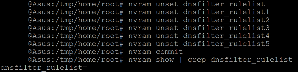

Maybe your settings are corrupted, one of the numbered rulelist variable contains bogus data. Try clearing them all, then reconfiguring them again from the webui:
nvram unset dnsfilter_rulelist
nvram unset dnsfilter_rulelist1
nvram unset dnsfilter_rulelist2
nvram unset dnsfilter_rulelist3
nvram unset dnsfilter_rulelist4
nvram unset dnsfilter_rulelist5
nvram commit

Sorry I edited my post after but I have 7 settings, with the 7th being a duplicate dnsfilter_rulelist. If I try to unset everything, I can't seem to remove the duplicate dnsfilter_rulelist, it keeps showing up even after trying multiple times to unset it
Sorry I edited my post after but I have 7 settings, with the 7th being a duplicate dnsfilter_rulelist. If I try to unset everything, I can't seem to remove the duplicate dnsfilter_rulelist, it keeps showing up even after trying multiple time to unset it
If dnsfilter_rulelist is one of the variables that's been moved to /jffs/nvram then what you're seeing is normal (you're using nvram show aren't you). The first blank entry is the stub that's left in nvram and can be ignored.
Right, I believe Asus uses dnsfilter_rulelist for their mobile app features, in which case they probably defined it as a "large_nvram" within wlcsm, and stored it to JFFS. Which leads to another possibility: is the JFFS partition full?
