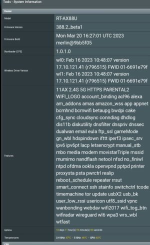

12 days!
The most stable relwase for me yet.
No need to reboot or such, no issues whatsoever.
I think although @RMerlin Asked to move radio discussion to other thread, i think should mention- since I did what I elaborated earlier, 36/160Mhz is stuck.
Not sure why it says only 13h are up, but no harm, no palm.
