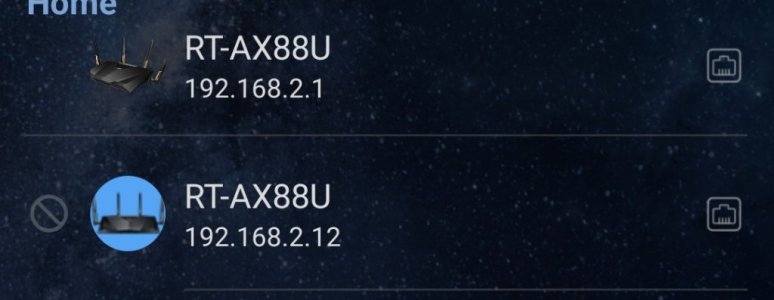

After hard reset, 24h of running, I reboot the router- when I do, the nodes are treated as normal clients.
for some weird reason, if both Router and AiMesh are not rebooted it does not work.
It'd work normally after I reboot the node.
Did somebody else test it?
That is not usual situation.
I hope it will be fixed before the stable release.

Edit: after 20m of running, the router located it as AiMesh Node and it fixed itself.
Weird thing indeed.
Not sure if this thing is in RMerlin's control or a bug that may be can raised, but it is a true bug.

I tried to do that, but I can report that after a simple router reboot, my node reconnects normally and is schown as a node.

Where was it shown? Inside Asus-App or also inside website?
I actually first seen it under web gui, then wanted to double check it.
So I entered the ASUS app and it was same there.
Anyway, whatever issues I had, whenever I had in ASUS app, relflected in the webgui as well.
