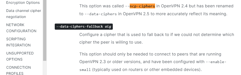

I think you may try to change the syntax "ncp-ciphers" to "data-ciphers". Because according to the reference manual of Openvpn, the former was replaced by the latter since Openvpn 2.5. Moreover, Merlin upgraded the openvpn module to 2.5.7 in the 386.7 firmware.
https://openvpn.net/community-resources/reference-manual-for-openvpn-2-6/
https://www.asuswrt-merlin.net/changelog
I will likely try, but since the tunnel is being established, briefly, I doubt this is the crux of the issue. But maybe, if there's a parsing related corruption or something like that...
