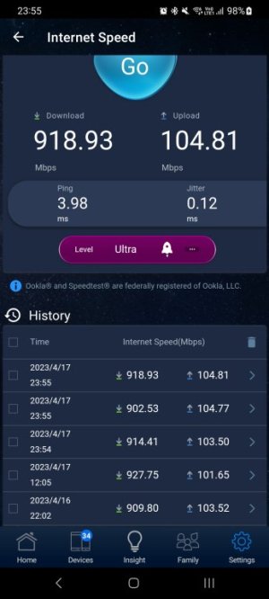

Hey, what's up? how do you get this speed in the build in speed test? I have AX88U whit the latest Merlin my connection is 980 down 100 up and when I run speed test on the router im getting 370 down 100 up at max.
Could be an ISP related issue - check your modem etc... I've never had issues getting the allocated speed from my ISP with any Merlin build as far as I can remember. But I run it stock without any scripts, swap or other items and run the modem in Bridge mode.

4 days in a row, nothing special to report.
Boring, usual and working.
Speeda as usual, nothing to exciting to mention... boring in other words.
