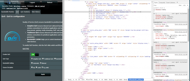

Those missing the QoS options, can you open your browser console to see if there's any error message?
Looks like the problem is those display:none element style, once comented on chrome developer options I was able to activate QOS again.
They are hidden by default, and shown when the router reports that it supports Adaptive QoS. That means either there's an error message preventing that Javascript code from being run (and therefore from revealing items), or the router thinks it doesn't support Adaptive QoS.
And there it is:
merlin.js:3 Uncaught TypeError: Cannot read property 'length' of null
    at getRadioValue (merlin.js:3)
    at QoS_EZQoS.asp:1244
    at HTMLImageElement.<anonymous> (jquery.iphone-switch.js:51)

I'll take a look, and push refreshed builds later tonight. The issue only occurs when trying to enable or disable QoS. In the meantime, here's a workaround. Over SSH:
nvram get qos_enable=1
nvram set qos_type=1
nvram commit
You should be able to access the webpage after that and do any change.

I uploaded new archives named 380.67-beta3b with the fixed webui (there was no version string change).
Ahh thats a bummer, the comment feature is super handy. Thanks for looking into it atleast
