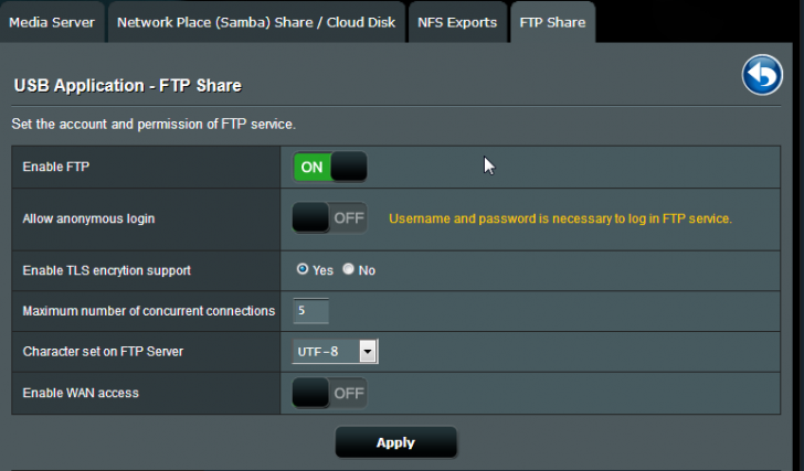

I use the FTP server to copy John's backup utility to my router flashdrive and copy back the backup files to my NAS. I only enable it during this operation, so I don't use it very often, but I find it is an interesting feature to have. The simplest FTP server is fine enough for me, no need to have lots of features.
It wasn't too difficult to implement, so I went ahead with it.

OpenVPN works better with TLS=0 (also with 66.4) instead of -1, even a reboot can't resolve the -1 setting.
