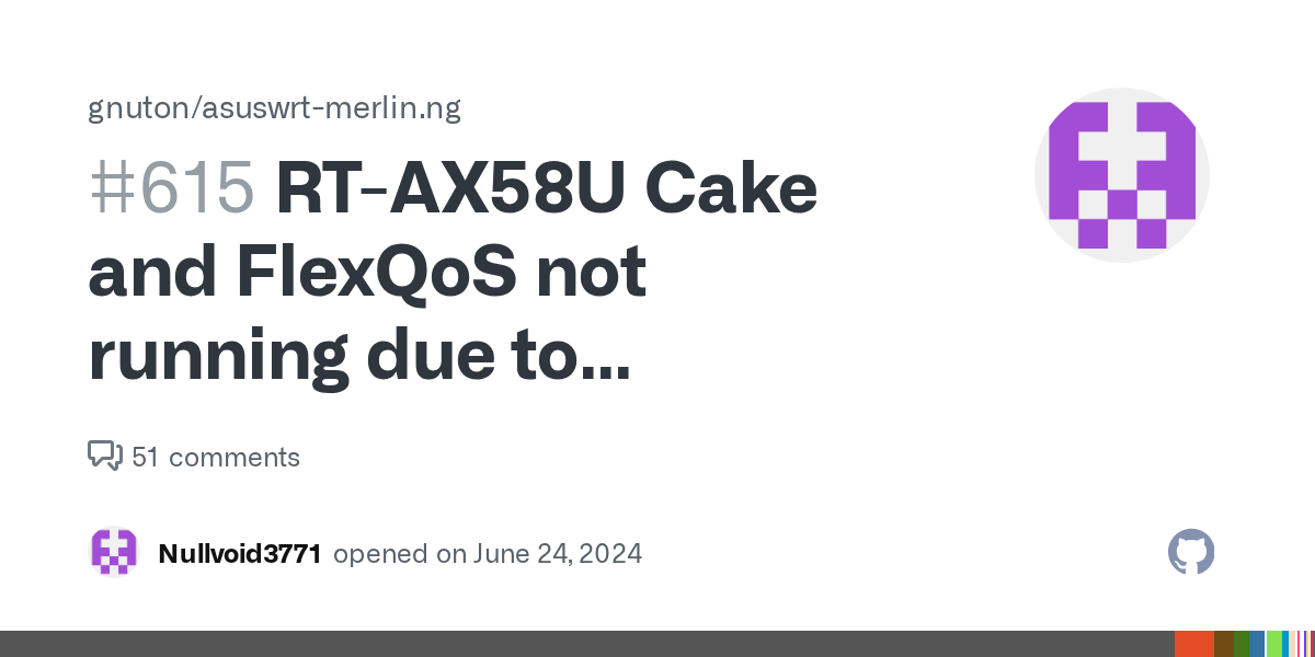

Remoted into their router. Doesn't seem to be disabling archer ssh seems to confirm it's disabled. but even though you reboot the router the UI and cake doesn't agree with the value. So this seems to be a GNUton issue. I'll make a bug report if their isn't one already.
Bug report posted:
The way the firmware detects Archer status on that page is by running:
/bin/fc status | grep "HW Acceleration"
Thanks that's helpful.
Archer is unfortunately still stuck on. But I can add this to the bug report.
I mentioned this in the bug report but I can see hwaccel under Tools_Sysinfo.asp in browser inspector, but was unable to find the reference once QoS Cake was enabled.
Edit: Had to go hunting for it but it's there.
If anyone one else had gnuton related issues with cake or flexqos please report your issue with gnuton on his github.
