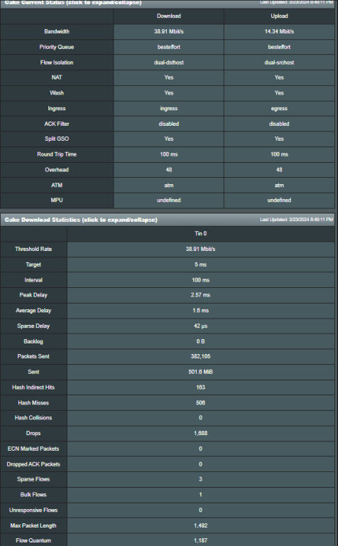

Hey guys, I need some help.
I got a DSL-AX82U router and no idea what QoS to use, I've been running CakeQoS for some time now and seems the best for my current scenario but I don't know if it's optimal for gaming or not.
My connection / Setup:
VDSL 40mbps download / 15mbps upload
I'm connected via a ethernet cable
This are my current settings:
Should I keep CakeQoS or go for FlexQoS?
Test both and see what works better on your ISP and games. Other forks around have different ISP and perhaps play different games.

Have you noticed any issues with CAKE?
As @Tech9 mentioned, try both and test both while gaming.
If you haven't had any issues with CAKE I would just stay with it.

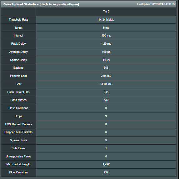

I tried FlexQoS but can't seem to properly configure it (I don't know much about network) and if someone for example starts a download the internet almost goes down, it goes to very low speeds, something that doesn't happen with CakeQoS, but when I look at CakeQoS I see "Drops: 56,869" and "Average Delay: 1.68 ms" (I don't know if it means anything)

The issue I have with CAKE is that my ping varies a lot with the current settings though it can be ISP routing issue because my ping is lower if I use a VPN or Exitlag
One example was when play Faceit in a UK server my ping was 40 while friends that live in Portugal and Switzerland had lower ping than me (I'm in Ireland), I decided to enable a VPN and my ping went to 26 (though I think this is a ISP routing issue)
