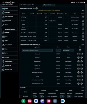

I am trying to test it out. I will look at it later today sometime. I am sure if I put in rules like some of the posters around here have I might trigger some kind of bad behavior. But apparently some of the posters around here get touchy about sharing examples. Do you have any rules that seem to be causing your router to reboot?
I had created a gaming rule and streaming rule when I owned the AX11000 Pro similar to below. This was a few months ago. However I'm back to the original AX11000 now so I can't help.
Thank you for sharing. I will try it out. See if I get any bad results. So, far I haven't had issues with the iptable rule Dave posted. I think he is on the right path though with his prior post.

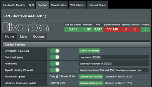

After upgrading for the latest merlin firmware, the flexqos is showing the diversion “page” instead of the flexqos page.
The help and support page is also giving me an error…
404 Not Found​
File not found.
I already uninstalled and installed, but the issue continues.
Can anyone help me?
It sounds like Diversion is overwriting the FlexQoS page. Would you run these commands?
grep -E "FlexQoS|Diversion" /tmp/menuTree.js
grep -E "user[0-9]+\.asp" /jffs/addons/custom_settings.txt
grep -F "<title>" /www/ext/user*.asp
ls -l /www/ext/
