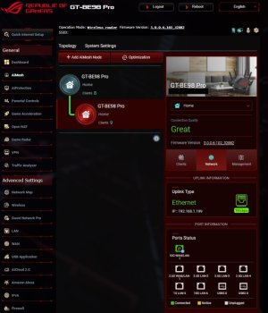

Setup my 2nd BE98 Pro in a wired aimesh configuration. Annoying thing it did after enabling ethernet backhaul was changing the 5 ghz wifi password so I had to go enter it manually and reboot some clients for it to connect. After that it's working REALLY well! I am really pleased with this setup. Can't wait to see the firmware update arrive as there are definitely some bugs with the web ui that I'll send some feedback to asus. I am also surprised both routers keep a nice balance on which devices connect to nearest router. Going to let it settle and add some other remaining clients but so far this is awesome.

Do you use smart connect ?
If so has any client connected to the 5Ghz radio of your node ?
I have 2 BE98's in a wired aimesh configuration, those have 2 5Ghz Radios
I do not use smart connect. But yes I do have clients on the 5 ghz channel on the node that are connected working with no issues.
No clients can connect on the 5Ghz Radios of my node BE98.
I guess its an issue with Aimesh on this firmware version...
2.4 and 6Ghz have no issues.
Without a doubt there is definitely some weird aimesh issues. Like I have the channel selected for 5 ghz but it is still showing auto channel selection. I know its working great but its just not showing it on the webui. Tried clearing cache of my browser too.
Curious, did you by any chance change any settings for the 5 ghz channel in the professional tab like the wireless mode? I always try to leave things on default. I was surprised how quickly clients nearby connected to the node that I have downstairs after I get it setup.
No, I left things at default for now as messing with something that isn't properly working atm would probably bring more issues.
What was weird though was, that upon enabling ethernet backhaul mode, I was asked to verify the wireless SSIDs and passwords,
The only ones that showed were the 2.4Ghz band and a single 5ghz band using the the _dwb on the SSID which is usually what Aimesh uses.
Some really odd thing happening with Aimesh...
Yes I actually sent feedback to asus about that. When you enable ethernet backhaul only 2.4 ghz and 5 ghz band show up, no 6 ghz. AND what it does is overwrite the wifi password for 5 ghz! I had to go back and re-enter it. It would take the 2.4 ghz password use it on the 5 ghz so no clients would connect to the 5 ghz band. Double check maybe make sure your 5 ghz password wasn't changed?
Using Smart Connect, so only 1 password is used and you cant change passwords for individual bands.
Oh yea that's right almost forgot. Guess we'll see when the firmware updates come. Probably will be soon anyway once people start buying this more. It's been out of stock at newegg constantly.
