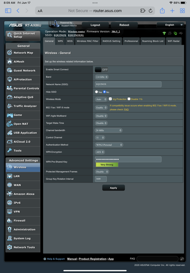

@seadragon, you can try the following:
- Go to Administration -> Privacy, and then click Withdraw.
- Go to Network Map -> Status, and then, in the "Ethernet Ports" section, make sure that your modem is connected at 1 Gbps (or more).
- Go to Wireless -> General, and for 5 GHz band, select the Auto select channel including DFS channels check box, and then select 160 MHz in the Channel bandwidth list (unfortunately, my router does not support 160 MHz, so I don't know whether this option is available for selection on your router; if not, select 20/40/80/160). Alternatively, you can try selecting 80 MHz.
- Make sure that Smart Connect is disabled.
- Restart the router and connect, for example, your fastest device (to 5 GHz).
- After the device connects, what are the reported speeds for it when clicking View List on the Network Map page?
- Run the Speedtest again, but from a certain distance, not too close to the router.

turn off the "a" and "b" and "g" modes on the radios. There should not be any devices that need those these days and that can drag things down if something tries to connect.
You should have only AC or AX if possible. If you have to have N for specific devices, then ok. Otherwise keep it off if config lets you.
@seadragon Can you confirm that your tests were done only using 5GHz and the client hadn't actually switched to 2.4GHz.
For testing purposes I would temporarily disable 802.11ax / WiFi 6 mode on 5 GHz and see if your speed tests stabilise. Leave Wireless Mode on Auto.
