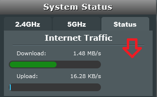

Thanks. It's something I had in mind during the initial development, but simply decided to put aside at the time and focus on the rest of the release instead. It's not perfect tho, I need to adjust the spacing to match the CPU meter below.
What change did you make to the traffic meter?

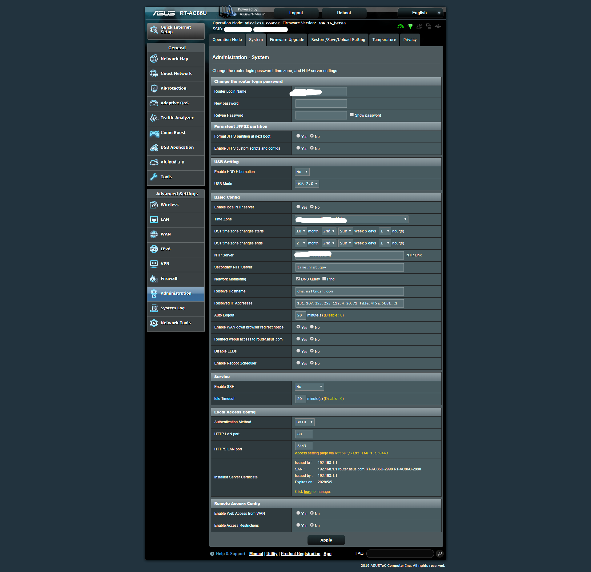

Under Administration->System, Basic Config section, there is a setting for Network Monitoring. Some have found that changing from ping to DNS query solves the issue. Double check DNS settings too.

I never had any problem with the fw, always good and fast, but this time the WAN LED went red and I wasn't able to fix it, so I returned to the last FW and everything worked fine ( after I turned LED OFF and ON, it changed from RED to WHITE ), the funny fact is that the webgui says that there is no connection but I have it in wifi and cable, with the Wan LED red or white, something got crazy.
I did some reboots and now is everything okay, but the router keep returning that has no connection, but I have, any tip?
Model - AC86U
factory reset it or try a dns change

same problem, check the screen.
btw, when I do a ``refresh`` the router shows the ``connected and all the details`` but after a second it change for disconnect like in the first screen that I posted.
This solution from https://www.snbforums.com/threads/r...-384-11-is-available.56501/page-7#post-488977 solved the issue for some.
The Change Tools -> Other Settings... and set "Wan: Use local caching DNS server as system resolver"... to "No"
I also have the dns query and ping disabled on my router.
CFE issue is another cause
https://www.snbforums.com/threads/internet-status-disconnected.59830/page-3
https://www.snbforums.com/threads/internet-status-disconnected.59830/page-3#post-536821
An option to change from MBps to Mbps via a little toggle option would be handy for this monitoring bandwidth usage :)
Old Meter
Which has some extra space to the right and the numbers and text above the bars
384.16
New one where numbers and text have been pushed to the right.
384.17
