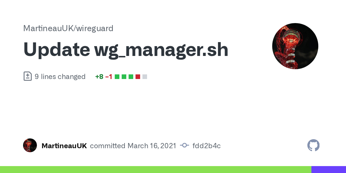

Update wg_manager.sh · MartineauUK/wireguard@fdd2b4c
Fix DNS 1.1.1.1 is hardcoded for Road-Warrior Peer .conf, use router's 'nvram wan0_dns' unless user specifies the DNS when creating the Peer .confgithub.com

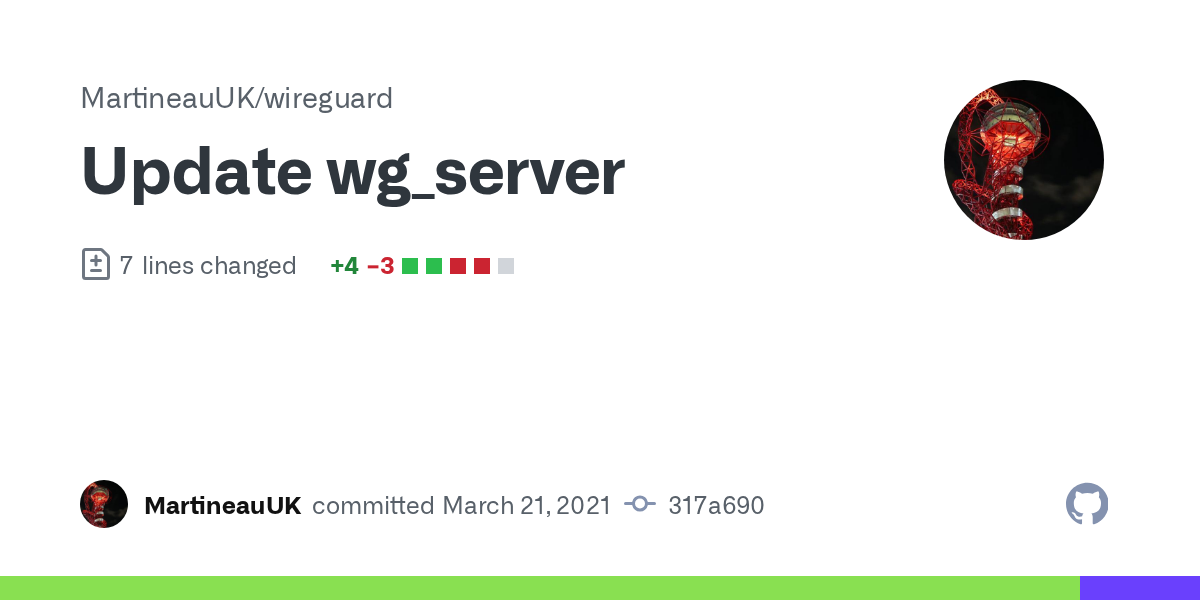

My second problem, after a router reboot my client still connects but nothing works, no internet, no access to local computers in my lan ...
Wireguard server is up and runnning, even if I stop it and restart it, nothing works and I can't find any log to help ..?
I have Diversion lite and Skynet running on amtm Asuswrt-Merlin 384.17
It seems like my wireguard server configuration can't survive a reboot?
Update wg_server · MartineauUK/wireguard@317a690
Hotfix If you have 'client' Peers say 'wg11' to auto start @boot, then as it creates its rules it loads the 'xt_comment' module, subsequently used by the 'server' Pe...github.com
